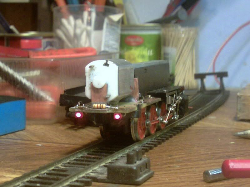

Steam Locomotive BR 64 Gutzold - improvements
http://trenulete.info/locomotiva-cu-abur-br-64-gutzold-imbunatatiri/
The locomotive is the oldest generation, but kept in the cabinet for years. Does the factory only with light bulbs in front lights, rear lamps are visible. Metal rods are the engine of the old guard, with discoid collector is technically exceeded, noisy and stinking though is exaggerated for this locomotive speed when attacking a hill, under load, mentally and physically inferior. Although the locomotive weight is well proportioned, gives the engine, for which, the owner asked locomotive restoration and replacing them in circulation to nominal parameters soon to be digitized.
Enter PanArin workshops, the car was immediately disassembled and engineers have found solutions to change them.
He was elected an 12-volt motor, a copier from Sharp, engine type that has been placed on other trains refurbished to Shed PanArin and which gave surprisingly good results. His speed is a proper super steam locomotives, the rotor rather than the inertial torque with a weight has increased over the Chinese engine, acting as if they have a flywheel.
It was decided that replacing the motherboard textolit coils were placed shock and nutritional engine blades to collect accurate and the blood of the three axles motoare.Am circuit board used to design and achieve a new motor and caring support adiacente.Prin tin, on a plate were Tufted stands for the new engine and the engine was a piece of tinned copper with metric threaded screw 2mm exact original engine set antic.Pe same nail plate have drawn the circuit wife power law would reconditionate.Placa new car parts will hold and engine power, will support and connect the blades to collect blood from the wheels and will hold electrinica point lighting and rear lights. At bottom, I planted two shock coils which are powered by electric motor. Also there I located and bridge rectifiers will supply both sections of headlamps, the front s8i rear. Point LEDs, red for the rear lamps are in series between them, the middle one being numbered 820 ohm resistor. Also on the bottom right position is found in collecting blood slides.
Sample of light before being electrically connected traction engine ...
Today, although the day off, the craftsmen decided to continue assembling workshops PanArin front lights, so earlier this week, tests on locomotive lines to enter the city from the living room and will then be sent to the owner for digitization.
will follow

Saturday, September 4, although the day off, the craftsmen decided to continue assembling workshops PanArin front lights, so earlier this week, tests on locomotive lines to enter the city from the living room and will then be sent to the owner for digitization. So they made the lines of Grandmother Gutzold rejuvenated and ready to tow to increase safety and trains just like her first youth ...
To begin to rebuilt front circuit board so that it be planted in two warm white LEDs and resistance of 820 ohms in series with each other after his princiouil E69.Placuta entered MPU applied to the right place of the old textolit and connections were made to the board through two wire copper line diagrams directly on the exit bridge rectifier. Between the motor and circuit board was mounted filtering capacitor positioned correctly this time, after the shock coils. This condensation was originally placed strangely before coils, as well reported in Mircea Ursu commented Peter sau.Dupa samples, circuit board and wire ends were painted with black matt Revell ... and was applied over the engine of self-adhesive foil black, to mask somewhat stoker engine cabin. Should be noted that currently there is enough room to install a decoder in the cabin.
Unfortunately, the owner decided to give up all its locomotives, so not much time to manage them and I said it would sell this beautiful toy for the price of 320 lei. Administration Bulmenberg regret that no withholding funds needed for this cute Depot PanArin grandfather and she hopes to get good hands, a depot where they are respected, loved and maintained by a steam locomotive enthusiast reconditioned and rejuvenation ... PanArin workshops.
